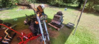

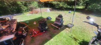

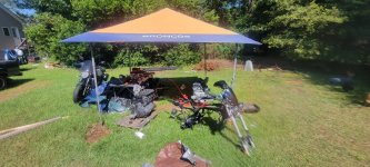

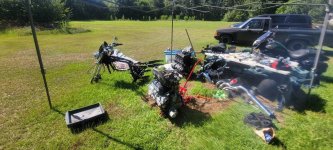

Well, almost a month later, I finally had a day off and got the frame swapped. I ended up swapping all the sensors, the starter, and the throttle bodies to the new engine. I matched all the plugs and then realized the battery was dead. It's always something, but hopefully, I will know if the new engine will run by Wednesday.
That really is living the dream, or roughing it, congrats.
I'll have to settle between living a dream and having to create shade like a tree because I can't exactly afford a workplace garage or shed otherwise. But at least I have something to block the sun while I work.
Yep, even when I was growing up we always had some trees we could hang a chain hoist from, and always had shade and cooler temperatures. But that was over seventy yrs. ago. You got to do what you have to do. Congrats.
