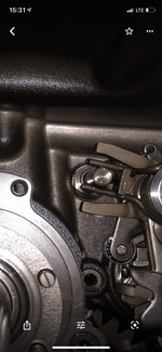

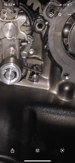

Before you undo detent spring please post a picture of how it is hanging. Over the top hooks better than up from bottom. I think it puts undo pressure on spring where alot snap. I bet yours is over the top and open faces bottom of engine. Thanks bud

Calling it a day. Tired and hurt like all get out. IMG_1203.JPG IMG_1205.JPG This is getting powder coated. Completely striped down and have new replacment parts. The hit marks on the cover is from a Raccoon i hit one night. Figure at this stage of the game i am going to do a valve clearance check. This way i can order new shims and have them ready. IMG_1207.JPG No issues here either. Chain and guides plus detent spring getting replaced. I have never replaced the detent spring but figure it is time. Of course this is not going to be replaced right now but final assembly everything will be brand new. Going to replace the kickstand sensor. It is very rough looking. The list of parts never stops.
Curious what you mean by over top or over bottom. Looks like it can only go one way.
