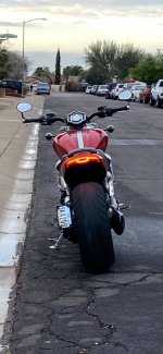

Scorpion tail delete is done - transferred the plate to the side of the rear wheel and moved the rear turn signals
The exposed rear wheel looks good. I think yours is the first bike with a rear rack and tail tidy that I’ve seen. It’s a nice combo.
Hopefully those turn signals are bright. I couldn’t run anything that small with the traffic here in Houston.
I from 2021 I was thinking way how to approach rear turn signals on my rocket 3 and placement you did was only option I saw in web, but did not like cables and brackets idea so drill them in the fender!

Difficult to see conclusively from the viewing angles & lighting of the photos, but the wiring to the new turn signals look a bit wayward/untidy.
Can they be kept tight to the bodywork?
