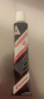

Reporting for my steps on easy oil fix:
1- try only tighten bolt to crash cooper washer - did not work still sipping!
2- replace the new cooper washer - no luck start sipping after 3 mile run to the stor!
3-replace cooper washer on special metal bonded with rubber oring- work for 3 days start sipping again!
4- unscrew the bolt throw away any washers, clean bolt with brake cleaner put under the bolt ( Hondabond HT ) and some Blue Luck, tights all the way in , wipe all squished gasket maker and live bike for 24 hours cured time! Since I installed Honda pice in my rocket3 I hoping for Honda reliability now possesses Triumph soul they bonded together and will be no oil sipping! Hondabond HT used in Honda’s engine instead gasket between engine block and oil pump so I assume it will hold 50-70 psi of engine oil pressure and small sipping will Not be a problem!!

Hi guys reporting back who was interested in progress with my fight on oil leak under washer!! Like I posted last time Hondabond HT did it job nicely after 6 days of constant using with a lot of driving in city stop lights and idling on parking lot I glad to saying it is DRY!!!! I assume the problem was in machining flat surface under the bolt washer and on my case it wasn’t! On picture it looks like it was gauge on washer surface!! So easy fix I can say now, 14$ hondabond HT and 15 min with the 12mm wranch and bit of blue lucktight !!
