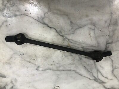

What does 'set' mean? When I removed the drive shaft to re-lube the drive splines, I discovered the bevel box end u-joint
did not operate smoothy in both axis. One axis was fine when holding shaft horizontally with spline in line with shaft and
then letting go of the spline. The spline rotated down smoothly and completely.
However, if I rotate the drive shaft 90 deg and do the same thing on other axis, the spline wouldn't fall downward smoothly or completely.
It would stay (set) in the same in-line position with drive shaft. It wouldn't drop down unless pushing (very little) on it. If I flopped it up and down, it wanted to return to the in-line position.
Hope that explains what I mean by 'set'.
The bike has 27K miles on it and surprised it's doing that with that low a mileage. There's no apparent damage when looking at it.
See pic of bevel box end u-joint. I have very little experience with u-joints, but this does not seem correct.
