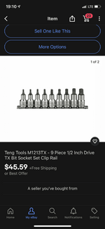

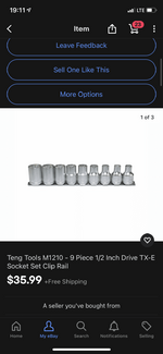

Teng tools. Excellent, they were recommended by Neville Lush and they are superior to any i have ever bought. They fit tight and with the 1/2 drive make easy work of releasing the bolts on the rocket engine.
