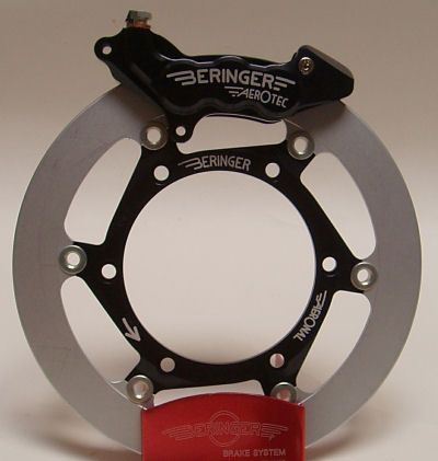

For your drooling
Beringer Brake System Triumph Motorcycle​
US$1,230.00
Per side;)
This cast iron floating front disc and 6 piston caliper kit is a direct bolt on application with no necessary adapters and works with the stock master cylinder. We have fitments for Bonneville (spoke and mag wheel), Scrambler, Thruxton, America / Speedmaster, Rocket III, Speed Triple, Street Triple, Thunderbird, Tiger, Etc. Shoot us an email for more info.
Motorcycle
For your drooling
US$1,230.00
Per side;)
Motorcycle
So is this the cost for the full brake system one rear and two front?
