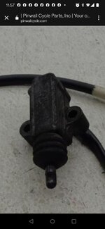

You r a little off on the explaining
But you r right on about the kickstand switch
Replace

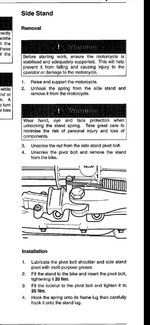

I may not be totally correct, but if you look at the switch it's in front of the stand and the switch looks to be out to me and when you bring the stand down it pushes the switch forward and in and grounds it completing the circuit, but if you look on your bike the piston is inside a box of some sort and you can't see what way it's moving, I looked at it the other day when my fuel pump relay went. If it looks easy I will try to unplug the connector tomorrow and see if it stalls when down and in gear.

And added hopefully shifting problem not this bolt loose Post in thread 'Gear shift issue - Not so common' Gear shift issue - Not so common
But if it is it would just move around with no resistance or not much, it wouldn't be moving the shift rod
