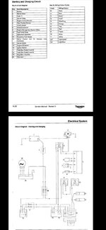

#8 in the diagram. Looks like normally open, so I guess you can check the continuity of the switch and see if it's open with the kick stand up, switch not actuated, would that be correct???
If not sure, one position should have continuity and the other none.

You might be able to track it easier with the diagram I imagine they are pretty much the same unless you have a new 2.5L model, Nope looks like mine 08 R3T GL

If you need the whole manual PDF look in the member IDK 's signature on here, it's in the uploads

IF you put it in gear with the kickstand down it will kill the engine
kickstand has to be up or in neutral to run
If you disconnect the switch it should start up or down no,?? It looks to me to be a normally open switch, when the stand is down it acuates it, and it would be closed circuit. I would think, just a guess.
And if I were you I would replace it cause sometimes you might forget to put it up, I've done it once, it's really Scarry when you find out in a corner 😳🥂😉
Just go here and order this $10 plus shipping.
Or a new one $55 + sh
But if the KS switch is stuck when you put it up it will still think it's down and kill the motor when putting in gear
good question
i think when when the stand goes up it pushes the switch button in
so i am going to guess that it the switch was out of position/bracket then it might signal the ecu that the stand was down.

also guessing if the switch was to stick it would stick in the off position

Yeah but an electrical diagram is drawn as powered, and actuating different switches changes things, if you pushed the start button it completes that part of the system, the ECU just adds everything up, if this is power, and that and so on, different things will happen, like the fuel pump relay won't make the circuit unless the ECU says it's ok to power the coil in the relay to pull it in, turn it on, the kickstand down should actuate the switch and will close it, cause it's normally open in the diagram, no??
I'd say we all are pointing to the same switch, replace it, unless the wire is frayed or something

You r a little off on the explaining
But you r right on about the kickstand switch
Replace
