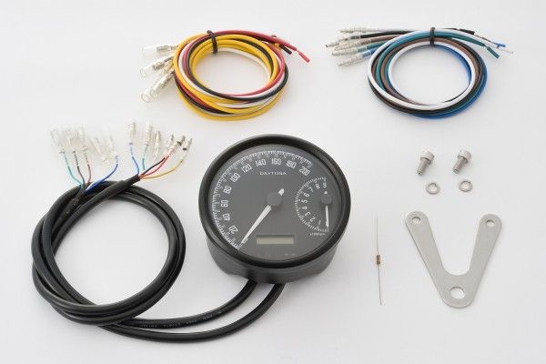

So - I am researching gauges for dear old Granny Guzzi as the replacement Smiths Speedo (not waterproof) I dropped in about 20 years ago has finally crapped out. The biggest problem being that dear old GG has a 100mm instrument - and there are not many waterproof 100mm about.
Stumbled across this from DAYTONA.
80mm O/D "VELONA-W" ANALOG MULTI INSTRUMENT SPEED & RPM - Daytona Europe
I know Ken ( @DEcosse ) mentioned Daytona before.
Just FYI.
