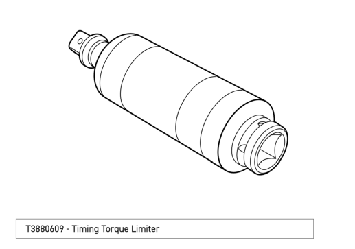

I've done many on the '11 Roadster. They do come out of spec. I'm about to hit 20K, so it looks like it's in my future. I think the 2.5s call for several special tools that are needed if you do need to replace a shim.
imcool
Supercharged
Feb 22, 2022
369
Rocket 3R 2022
here are the special tools you need for "" Valve Clearance Adjustment "" and ""Camshaft Timing Check Adjust "" , I researched before hand and gathered information in case I ever decide to do this
Crankshaft Locking Pin, Part Number: T3880501 50usd
Camshaft Timing Bar,
Part Number: T3880502 60 usd
Torque Limiter
, Part Number: T3880609 255usd 0.6nm or 5 inch/ lbs
now, the Torque limiter is the costliest tool from triumph 260usd, but there is an alternate which is this one
$54.99
( do not get those cheap variable torque screw drivers from amazon they are not good at all for such a small torque. Must get a fixed torque tool like above )
Alternate for remaining 2 tools are :-
Crankshaft locking pin: substitute an ordinary Phillips screwdriver ( I think that it is 8mm in diameter)
Crankshaft timing bar: substitute a 7mm hex wrench with the end cut off (cut the bend off)
