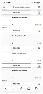

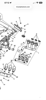

Hey I'm trying to figure out what gaskets I need to order for this carpenter exhaust, I'm getting a lot of different answers between Google and chat gpt... Does anyone know the correct part number? Are they round or oblong? Im stumped and I am trying to get them ordered before the carpenter shows up. Any help would be greatly appreciated. I just found something maybe? NEW GENUINE TRIUMPH TT2200326 Exhaust Pipe Sealing Ring but on the site it says it requires 6?? Is that correct? Again any help would be appreciated thanks .

I sent an email, and I called and left a message, Erik is a busy man there pretty short staffed so I try not to bother them any more than I have too, I'm pretty sure I got it figured out, after reviewing some schematics and some older pics of rocket 3 cylinder head exhaust side there oblong and the part number is T2200326.
Correct. All pipes use same, where pipe connects to head. Theyre are no other gaskets on carpenter pipes.
