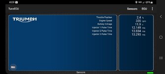

I do have TuneECU, just haven't used it in a long time. I had to update it and register it on my new phone. Unfortunately there were no error codes at all; I've checked numerous times. I'm attaching a screen shot of the injector pulse time.

**The screen shot is from today**
