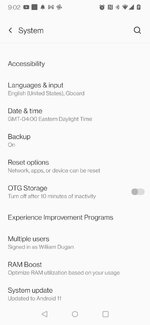

I connected the Cable to one of these, then ran the phone cable out the other side of this into the phone. Is that my problem?
You know you should take the headlight fuse out and put a charger on the battery when running tuneECU, look in settings under system does it say anything about OTG
