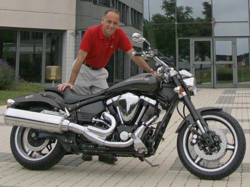

Here is my thinking. Once I get the Jardines I will look and see if there is any potential in working backwards from the header.
Truth be told, the maximum power and lightest weight will be obtained from a free flowing header, properly matched collector, and into a single pipe/large single can.
The problem is it conflicts with the supercruiser look on some R3's I've seen (IMHO), though the Warrior does come to my mind:
Black:
Red:
With that big can, it might actually fit the look of our bikes and make max power. Don't know about riding with another person though... Also, since that Yami can is factory, I imagine it is quite heavy and restrictive.
