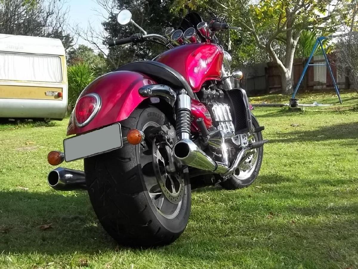

Hi Paul, I'm not a fan of the external silver coatings. They seam to dull over a short period of time. Is it possible to have them triple chromed and heat coated internally ?
On a separate note, I saw a picture of one of your 2 pipe systems for older Rockets that looked like reverse cone. Please tell us about that exhaust system.

What you would have seen is my bike, '06 model, with a 1 7/8" O.D. cross over pipe fitted up to the stock header with two 2" large bore mufflers fitted along with a cover to cover the header to muffler joint.
(Note no chicken strips on the rear tyre)
This system is in the development phase as we speak.
Whilst this one was built for the earlier models, and I intended to get it into production "as is" but then decided to modify this so it would fit the Roadster (thus clearing the ABS unit).
This would then retro fit the Standard/Classic models, so one pipe for two models.
Touring riders, you are being kept in mind as well.
This system, along with K&N filters and a tune to suit really woke the beast up, great torque and bounced off the rev limiter real easy.
Cruising on the open road at 120KPH and coming up behind traffic moving at 90-100KPH I would drop back to forth gear, not because I need to, but because whacking the throttle on to pass gave such great acceleration (and adrenaline) that I was doing 100MPH real quick leaving said tragic as a smaller image in the mirror.
This with the stock header !
I've been told this system sounds very much like the Jardine twin system, it has a deep rumble that is just a lovely "drum beat" when cruising on the open road, very much like a nice sounding V8 has when cruising.
