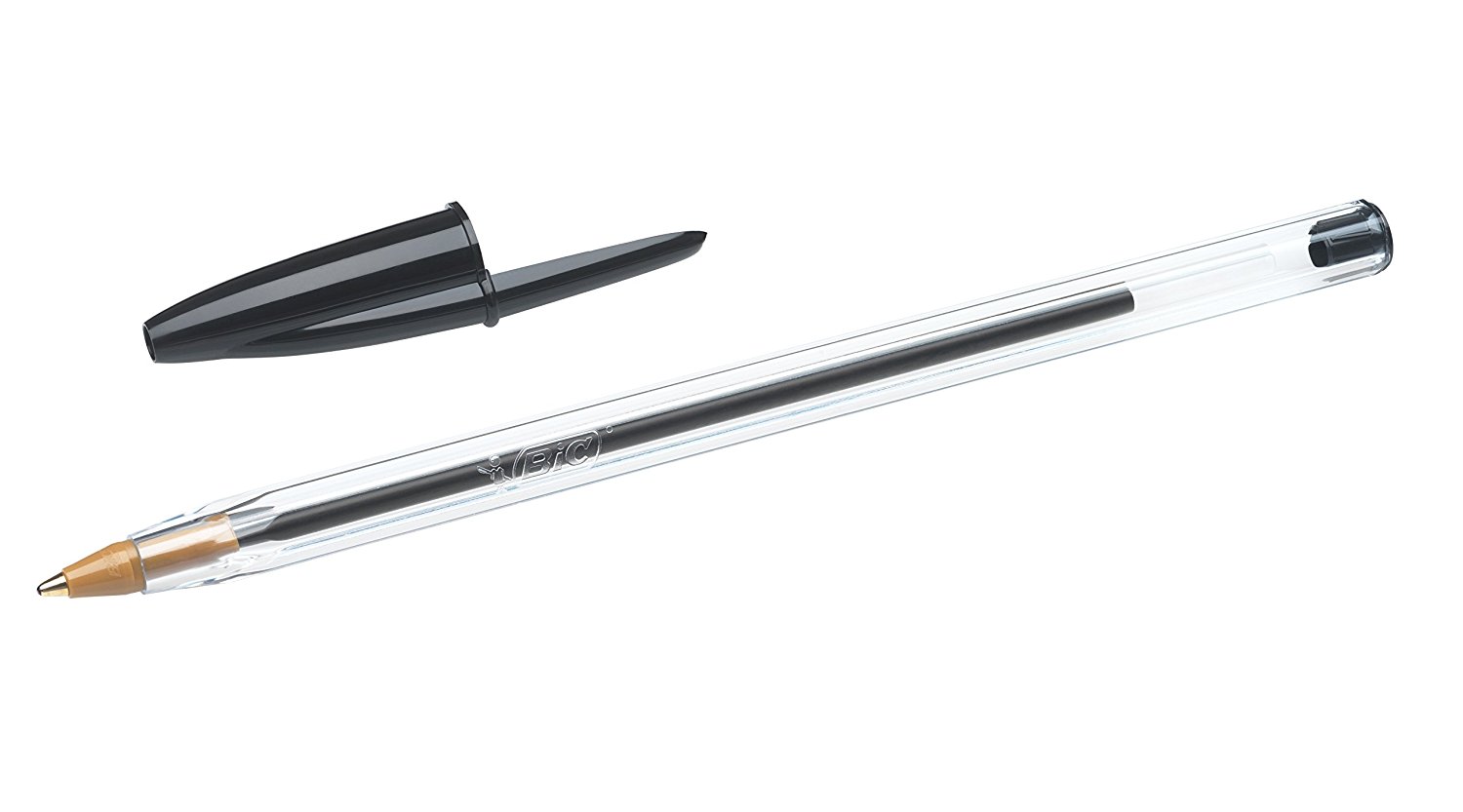

Drill holes and insert hollow copper or other material tubes/straws/pipes so that they protrude at least 5mm or so externally and similar or more inside. These could be red plastic or even lengths of a clear crystal biro bic pen case etc. What ever floats your boat.
For rear facing ones this would allow water to run off the pipe end without entering the light casing while any slight moisture would be evaporated by the heat from the LED exiting through the tube. Side, top or bottom facing tube ends would also have a venturi effect when riding to keep water from entering or remove any that did while stationary. You could even angle all of them downwards so that water runs off when stationary and not into the tube at all.
