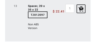

Non abs spacer for touring roadster and classic if someone close has one, i will measure and take pictures in a few of one i think i have extra
