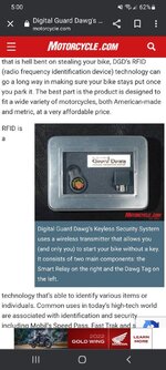

This is the system I have. It seems like it just replaces the starter relay. Cool concept but pretty old and that's probably why I suspect it's failing. I'll replace the relay sometime this week and try that.
