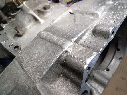

I think welding is out of the question, without possibly trying on a completely stripped case. Too much material drawing away heat, I think, would make a weld job "iffy" at best. I do have a nice TIG machine, but never tried aluminum yet. Just kicking things around. 2005 that has to be split to fix shifter, 2013 with broke mounts. Guess I just have a pile of spare
I think welding is out of the question, without possibly trying on a completely stripped case. Too much material drawing away heat, I think, would make a weld job "iffy" at best. I do have a nice TIG machine, but never tried aluminum yet. Just kicking things around. 2005 that has to be split to fix shifter, 2013 with broke mounts. Guess I just have a pile of spare engine parts huh?
You should be able to weld those mounts using the right gear....a mate of mine is going to weld up a hole in the case without pulling motor apart....he's been in the welding game many many years & reckons he can do it
I've seen his welding before & its impressive!!
I am not a welder
when i have had trans cases welded they set the cases broken area facing up.
so when they weld that section usually falls a little. so if it would be a prob u might need to stabilize it
Depends on the purity and composition of the aluminum, seems like I read somewhere that Triumph was using lower grades of aluminum. Cleaning and fitment could also be problems.
