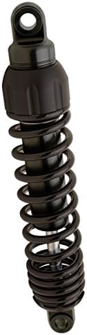

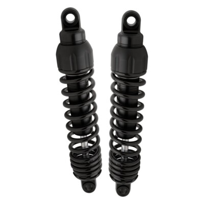

USA and postage .. eBay has listings. as does Aussie Amazon.com.au Compare a few offerings by googling the part code for the one you want
You won't get them any cheaper with the dollar rate and freight now.
Eg
444-4213B
Note there are 4-5 different grades of Progressives for Rocket IIIs besides length in 11.5, 12, 12.5, and 13" length and colour options. 12.5" is stock.
13" is a much better ride if your not too short.
A base stock replacement 212 series, mid 430 and better 444s twin shocks and then there are the HP piggy back etc.
Eg
MSRP: US$781.95
444-4213B
444 (BLK) CRZR 13"
Out Of Stock
Estimated Ship Date : 1/3/2023

Progressive Suspension 444-4213B Black 13" Standard Big Mile Riders Rear Suspension Shock​
$963.01
FREE international delivery
Usually dispatched within 4 to 6 weeks.
BrandProgressive Suspension
PositionRear
StyleModern
ExteriorChrome
ColourBlack
About this item​
  • Frequency Sensing Technology (FST), allows the shocks to sense the frequency of a bump and automatically adjust damping for superior ride quality
  • Deflective disc valve
  • Adjust spring pre-load by hand, no special tool needed
  • Progressive rate spring
  • Standard spring rate and black finish

Thanks guys. Amazon website only has 444-4212B and 444-4214B will these fit my 2015 R3 Roadster .
T
Jesus, just click on the 444-4213B link I provided and buy it. I just tried and could have bought it and sent to my Aussie address with FREE postage.
T
Nope 13" far too light a spring rate if it fits these bikes:
444-4212B
Shadow 500,V65 Magna,Eliminator 1000,Bonneville
Nope again 12.5" version of above.
444-4214B
As I posted yesterday in my alter ego the link I posted to Amazon.com.au in Aussie dollars way back is still working.
