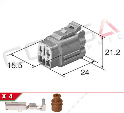

Need Info on Fuel Pump Electrical Connector + question on discoloration
This one looks more like it, although again, would prefer to see a better picture
The positive keys on the outside and the dual slots in the centre certainly look correct (vs the other linked which is definitely not a match)

Yes, that's the one I linked
OK, thanks for the assist.
Rather than try to match the existing wires I will buy 4 color matched 20 gauge wires from them, build the connector, and splice it to the current wires.
I will also apply some liquid tape to the new connector to strengthen the wires.
Much appreciated.
I ordered several colors of wire & the connector. Parts = $6.50 Express Shipping = $9.50 so I will have time to install it before liftoff for the big trip.

4-Way Kit Sumitomo (TS090-4S-6) - TS 090 Sealed Series​
1​
$4.48$4.48
Socket/Wire size:
.3-.5 mm² | 22-20 AWG (TS090-SKT1)
Insulation/Seal size:
1.4-2.0 mm | .055-.079 in (TS090-SL2)
They ship fast
OK, I received the new fuel pump connector and had a friend help me assemble the pins and new wires (using solid purple, solid grey, solid black and solid red).
I plugged it before splicing it to the harness and it fits - yeah! Correct plug and pins seem to be installed properly. Thanks @DEcosse
