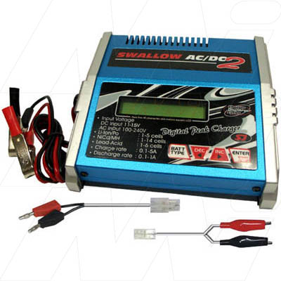

I have a RC modellers type charger I use for all my batteries that covers charging, discharging and cycling batteries using either AC mains or 12v DC battery sources. This would convert 12v from his bike's lead acid or Lithium M/C battery to 12v for his Lithium Solar set up. Just saw the
Lipo balance accessory SJLCB-6C bit. I had better start hunting for one now!

ME Lipo Balancer LCB-6C This is the Lipo balance charger accessory for the SJACDCSWALLOW charger
www.rcgarage.com
SJLCB-6C
Swallow AC/DC #2 Digital Peak Charger (Cont.)
Input voltage: DC input 11-15v 60w, AC input 100-240v 50/60Hz 0.5-1.0Amp
Output voltage: 1.2-12v max 50w
Li-ion/Po 1- 5 cells
NiCd/MH 1-14 cells
Lead acid 1-6 cells
Charge rate: 0.1-5.0 Amp
Discharge rate: 0.1-5.0 Amp
