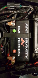

Fitted Anti gravity to my Stage 3 TTS Supercharged Rocket after the last battery gave up the ghost ,this one spins the rocket over like an electric drill ( does have upgraded starter motor and leads as well) kept on an Optimate lithium tender ,no problems yet .
