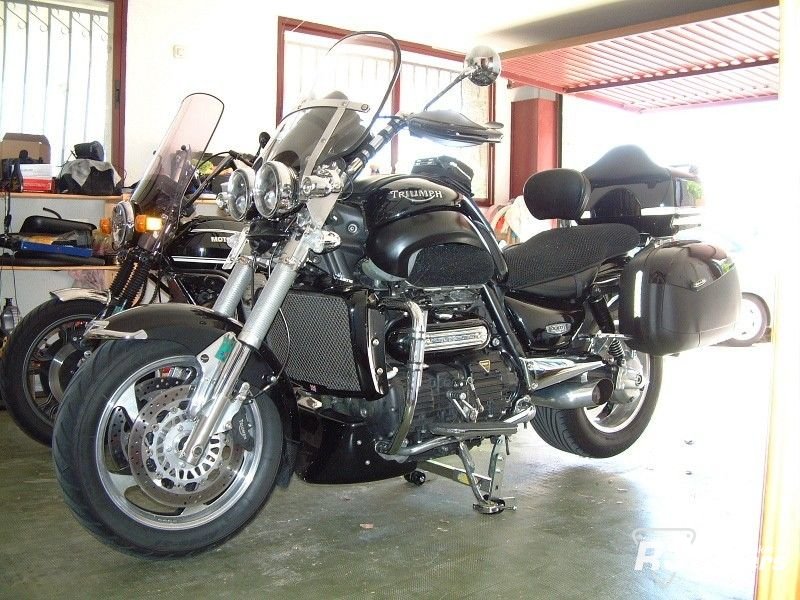

Thanks Jvheli! Doc's set up looks awesome. Now imagine the aluminum strap across the top with a "140 Cubic Inch" oil tank embelisher on it.
All about making it yours! I think that would look great! Now, finding one of those might prove to be difficult! I was lucky to get one from @leatal .
What's the size and # for the ones that fit under the Claw? Perhaps someone has a set lying around gathering dust.
Sorry, Ricardo, I gave my set away long ago- K&N2780s

It's displeasing me ! If keeping the bear claw intact , I would put another Ramair on but I am liking the look of the pods exposed . Makes the engine look kinda bigger !
Yeah! That tiny little sucker does need to have a larger look alright!

RX 4010’s with a cut claw. I do feel it on the leg but I’m used to it now. The intake sound is intoxicating.
That is possibly the best look i've seen!...love it...so much that i think i will go the same way.Everything is the right size and keeps it all in perspective..to me. Those big suckers will really get air..most important....NICE.. big time!
