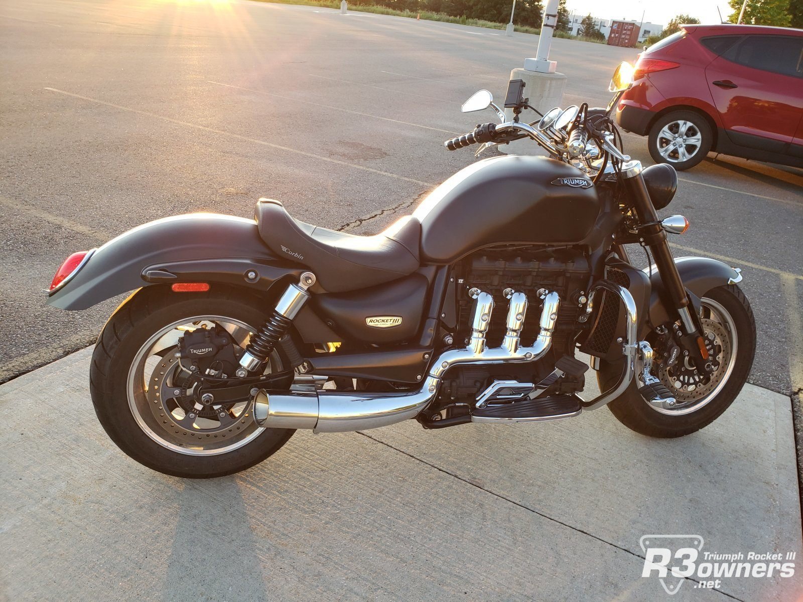

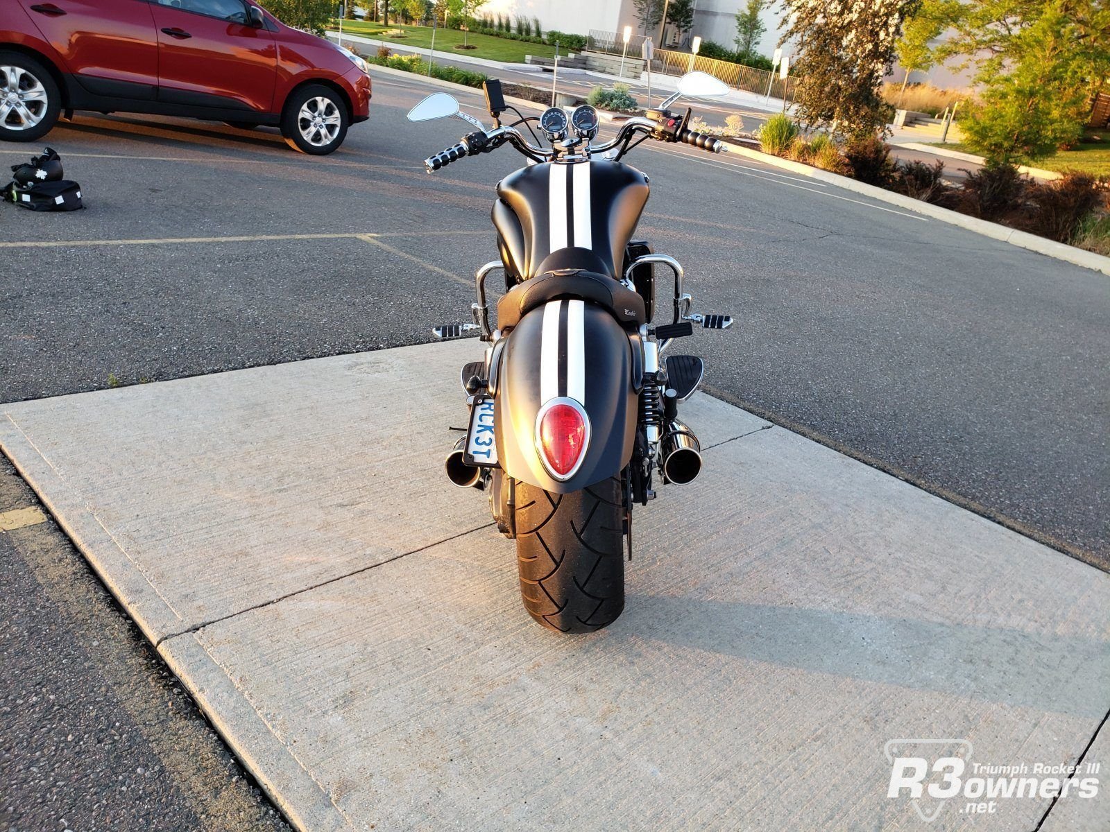

Installed the Dave Platt Outlaw Exhaust system!!!
The sound is amazing!! The growl & bark now match the spirit of the Rocket 3 Roadster!!!
Only took about 2 hours (would be less if I had a proper shop, a bike stand, and it wasn't 35C outside)!
Stock system came off pretty easily, Dave's design fits like a glove, no issues.

My 2014 Rocket 3 Roadster (Before)
My 2014 Rocket 3 Roadster (After)

Update: I'll still take a map if one's available but just got to get a re-map done on the bike for Friday (need to get rid of the cats in the map at the very least). Seems to be running rich with some back firing when down shifting or throttling down.
Regards,
That there is indeed the symptom. Better men than I have already expounded - This in inevitable to a certain extent due to the tiny muffler size. It can be mitigated - I am sure - but probably not eliminated.
