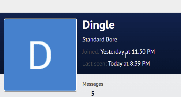

Interesting, joined yesterday right after Richard's post and started posting right into Richard's thread and has rocket at least 2 year old.
anyways, welcome
@Dingle
anyways, welcome
@Dingle
Posted onto his thread because I bought a kit from him, his thread was asking about bikes that are complete. I've never posted to these forums, but have used the info on them for various things (penner's maps etc)
