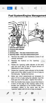

Check this before spending your money. This fixed my sporadic high idle. Follow the throttle cables back to behind the overflow tank. Road stuff gets in the throttle Springs and binds them up. A healthy dose of WD 40 and my fast idle was gone and had never returned. Cheap fix.
there is a little gismo in there that will let it rev to 5000 rpm while holding throttle closed. that sticks.
i have fixed mine several times but i live on dirt road:confused:
