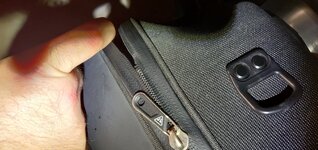

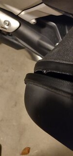

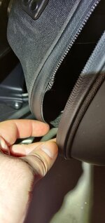

By broken do you mean the zipper tab broke off the slider, or something else?
The nylon rings (the pieces that interlock to "zip" together) broke off and got tangled up or half pulled off of the zipper-track AND the entire zipper piece (the cloth piece the zipper was attached to) separated from the bag in a couple of places. It happened in 3 spots on my left pannier.
Wow. Mine not showing anything like that, just not smooth at spots. Tried wax.

Dropped oem bags off at luggage repair shop. Said problem is the sliders, not the teeth. Pick up Friday. 4 sliders= 60.00. If they work better worth it.
Love how easy to remove,add bags.
Will report results.
No go. Not the sliders. Nice guy said no charge to put old ones back.
Looking for auto upolstery for steel teeth.
Yea I've been certain it's the ****ty nylon teeth. Brass or stainless teeth should increase the weight capacity of the bags too, as I think the nylon teeth are likely lowering the rating on them. You'll have to have the cloth zipper strip removed and replaced with an entirely new zipper strip. I'll have to hand stitch it when I do mine.
