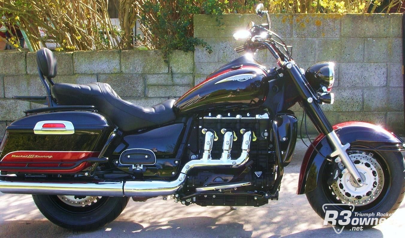

Well, tastes differ, but I prefer something other than black powdercoated wheels on a Touring model. The front wheel looks like a big balloon. On a fully blacked-out Roadster, perhaps, but the Touring needs bling. :)
The wheels are essentially untreated aluminium, except the inside of the spokes and parts on the hub which have some kind of silvery coating (I'm guessing powdercoat).

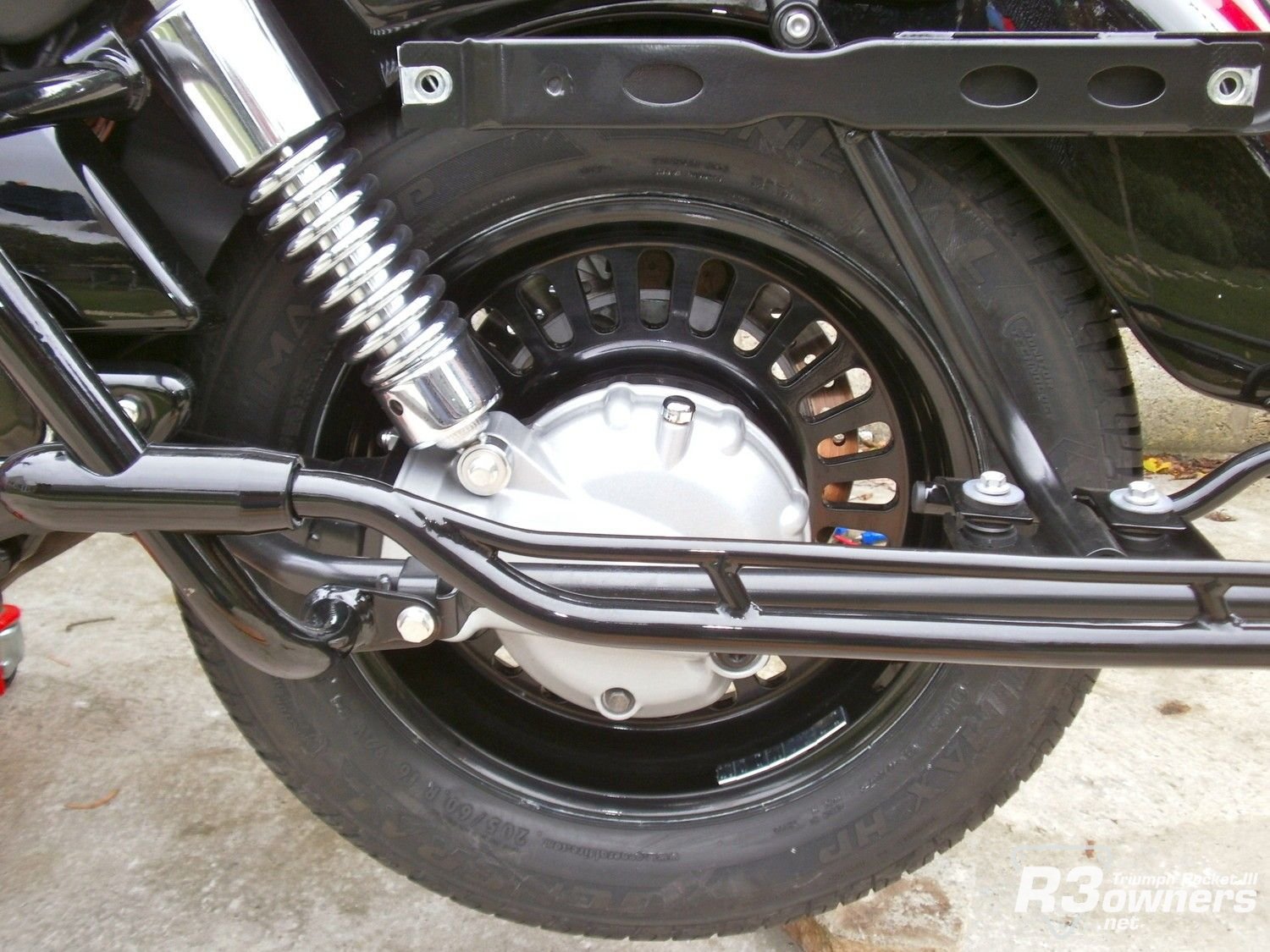

Here's a picture from when I detached mine to do the LED taillight conversion. The area marked 1 is where you can sorta see where the fender was bolted in on both sides. The other areas are what you'd have to remove to get the right-hand side pannier rail out of the way. After that, polishing would no doubt be far easier. Removing the fender is quite easy and you don't need a stand or anything.
