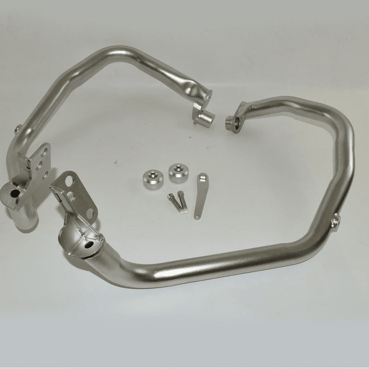

Went with this set from Mad Hornets. These are available in silver or black. A little tricky to install but very solid and well made. I wasn't able to use the spacers that came with it, but used washers instead to get the proper fit. They did take several weeks to ship but all in all I'm very happy with them. I have some highway pegs for them coming from Amazon and should see them Tuesday.
Price- $235.98
SKU- CBP-188-SIL

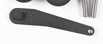

Hi, I could not get much luck with channel on the mounting details. I think not many folks login here. But one of the folks in Facebook R3 group was kind enough to share these pictures I have attached here. It gives an idea on how they can be mounted. Yes, the top screw mounting the engine has to be taken off on the right side. It looks too risky for me to try myself. So, I took an appointment from the local dealership to fix it. I showed him these pictures and he seemed to have figured it. My appointment is a month away. I will post the details after it's mounted (assuming that they are able to do it). Only one thing I could not figure out yet (and even the FB guy did not know) is where that short 4" piece should be fitted to. If you find out, please let me know

So, we don't know what that little short piece is and why it is in the set?
