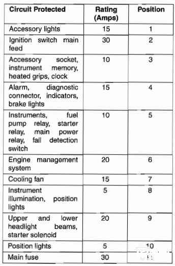

Fuse #6 is good DEcosse
I pulled it out and its intact

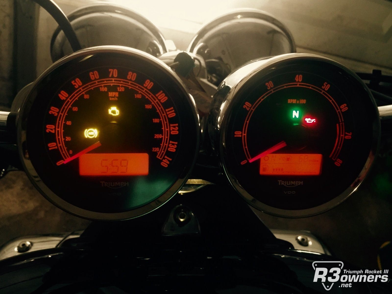

There's good news and bad news this afternoon
Gauges have stopped their synchronous flashing back and forth between them.
Then the fuel pump relay has stopped clicking on and off too.
The fuel pump has stopped firing and the bike is silent when I turn the key on.
(Except for the sounds it usually makes as it boots up).
However the gauges wont light up at all now.
Its black out - bike starts though, and idles just fine.
Had it running in the garage for about ten minutes, revved the engine - everything appears normal.
The indicators, lights and horn all work just fine.
Gauges flickered a little and you can see something at home in there - warning lights lit up for a second, then went out again - so its trying.

Got to love those ECMs - went to work this morning, no gauges, just the odd flicker but sunken in solitude.
Bike cut out twice, restarted both times - so was able to keep moving.
Was thinking maybe stepper motor(??) is it the fall detection switch acting up (?) is it that ECM unit trying to dump its tune (?)
Parked at work for 8 or 9 hours, to get paid to do something, got on to leave - nobody home in those gauges, pouting silently.
Started up and rode home - no cutting out at all (?)
Sitting at a light waiting, look down - gauges are on, displaying innocent as you please - all present and correct.
Engine warning light on, so tomorrow my buddy is back - will hook it up to the service laptop and hope we catch that error message.

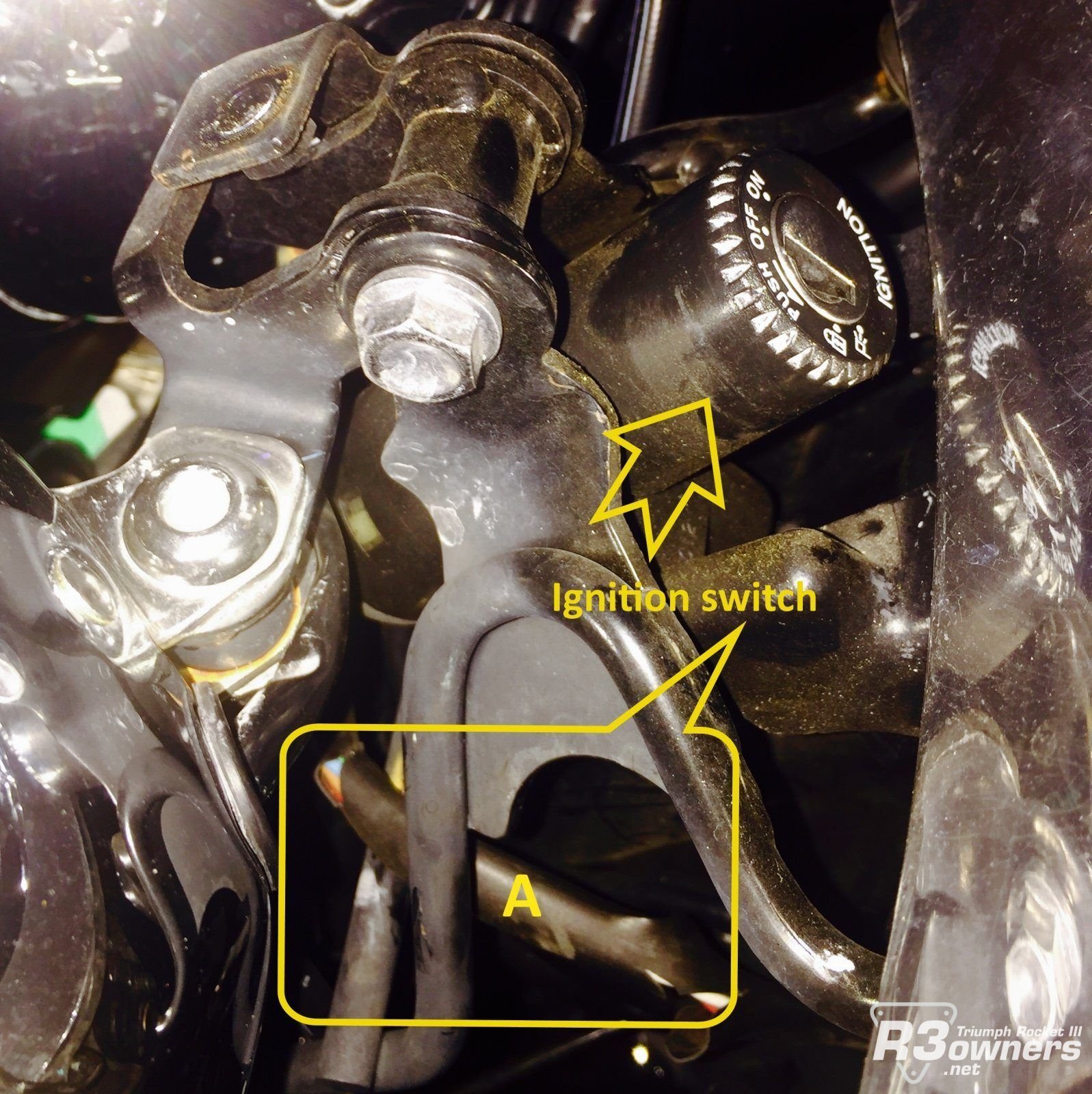

Noticed this morning that the ignition switch is not as responsive as it ought to be when turning the key.
Got to work just fine - no cutting out but once I'd parked - time to come home, the ignition would not turn on.
Took the key out the ignition, turned it around - put it back in again....still no response.
Did this three or four times and finally the bike was willing to start.
Rode home (without any gauges) and there, exactly as happened yesterday - the gauges suddenly sprang to life and acted as if nothing had happened at all.
Innocent as you please.
Got home and after leaving the bike to cool off - decided to open up the ignition switch housing and see what's going on with that cable running up inside there.
That cable I've marked 'A' runs in from under the tank and has a cover over it, which was tight.
So pulled some more of the cable through as slack to the ignition switch, put the cover back on and rubber boot.
Stuck the key in the ignition and turned it on...
look that happened
Hopefully it's fixed good detective work.
