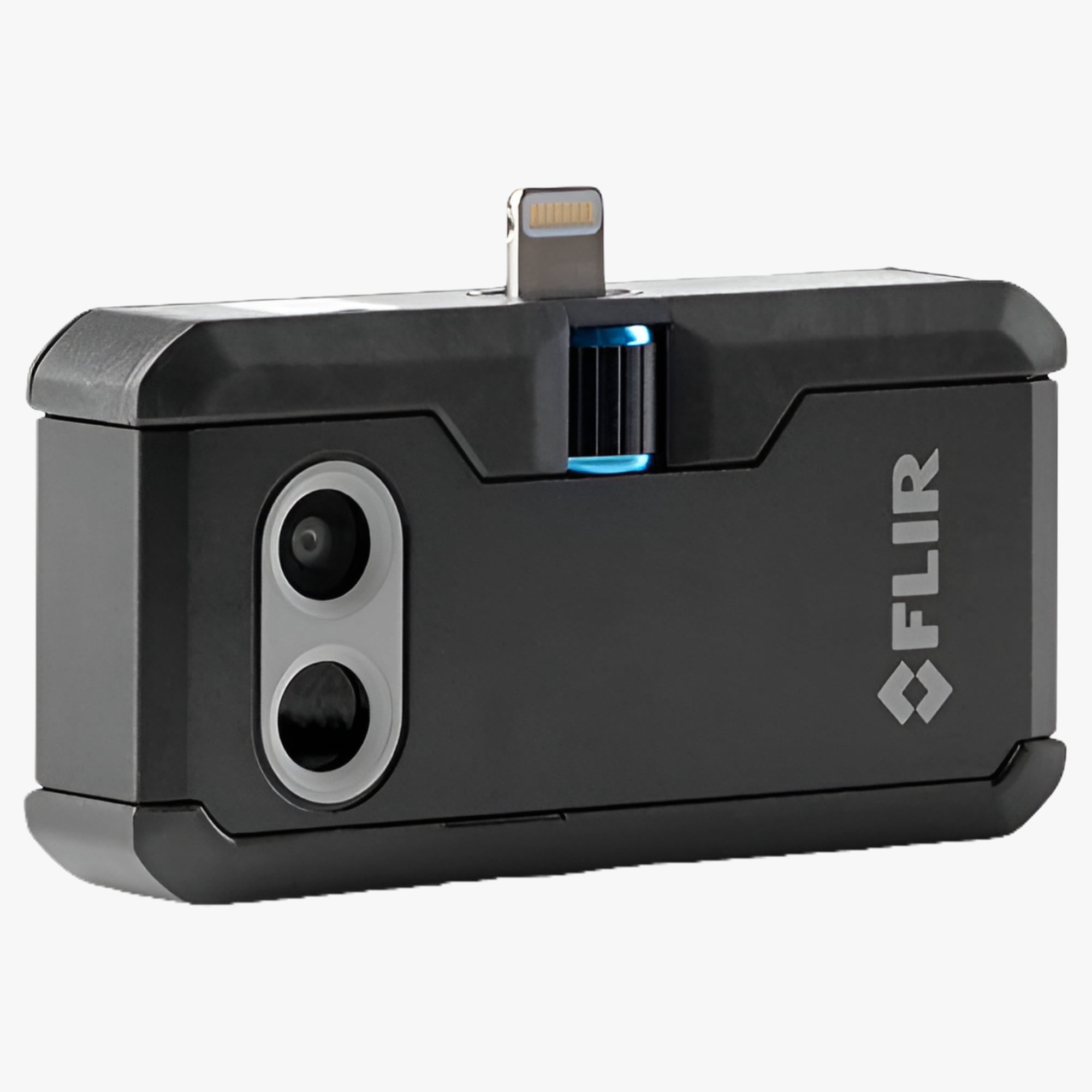

This does NOT match with what I measured. I used a thermometer with a probe and I was able to see 680F. I will make another test this coming weekend affixing better the probe and accelerating more the engine and see.
This is the camera I used
$349 USD camera, tried and tested on human body and other places to verify temperature accuracy before I took that rocket engine exhaust reading.
