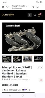

Vandemon in Australia do some nice looking headers also....bit pricey though...
