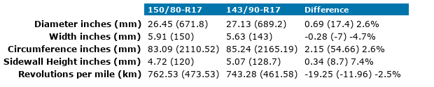

Oooh I dunno - Measure a Metzler fitted to a rim. my 150/80R17 ACTUALLY measured 143 across fitted and the height calculated out at 90%.
That's a 2.6% difference on the same tyre simply because it does not fit the rim PERFECTLY. Actually the sidewall height was a wee bit taller But the Tacoma calculator takes 90% as the highest aspect value

Oh and managed to find this.
