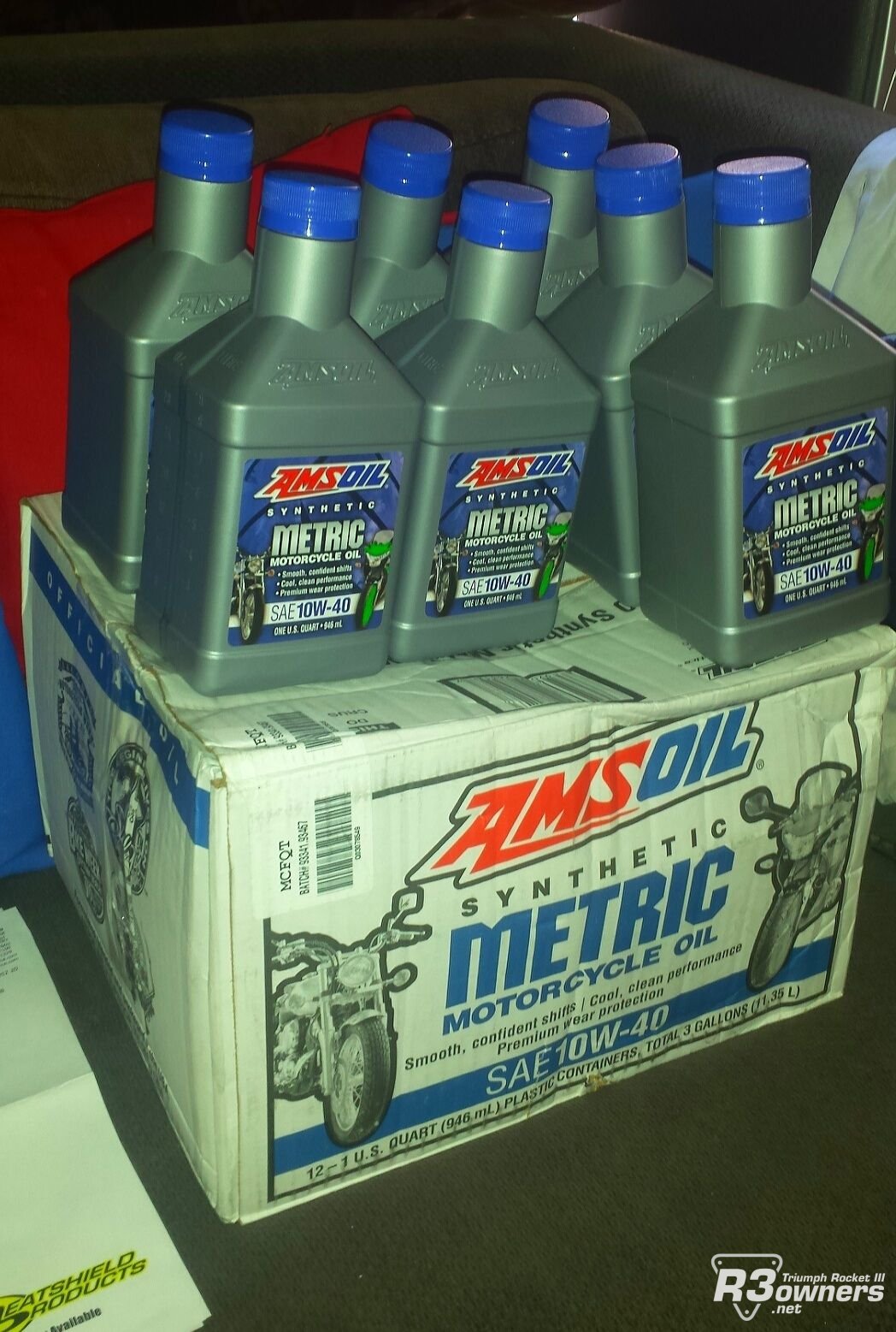

amsoil formulation?

I've always appreciated the testing done by Amsoil.
http://americasoil.biz/files/g2156_A_study_of_Motorcycle_Oils.pdf
Before you role your eyes, scroll down to the summary of the oils tested. This is a scientific study done on the synthetic motorcycle oils available several years ago. Most of these oils work, but some are very good. I look at the viscosity breakdown charts since our engines share their oil with the tranny. Instead of a gut feel, this study will give you some data on oil performance to help you choose your poison.
BTW, I currently use Amsoil 10W40, but have used Mobul 4T, and Shell Rotella T6 oils with no problem. Any motorcycle oil is good if you change it often. If you change oil when Triumph recommends (16,000 kilometers), then buy the good stuff.
