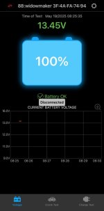

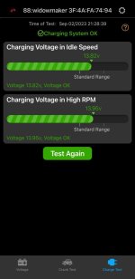

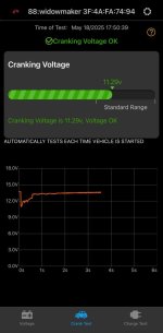

Install a wifi battery meter and you can see exactly what charging system is doing and you can see parasitic draw from rfid remote stuff and other things drawing. Over time you will see when battery degrades. My cranking voltage has been low after this past winter when battery froze and cut off, i had in storage and it took a hit, no charge 6 months and frozen at some point, but it lives.

I'm with Kiwicol on this one. The charging system is not built to fully charge a LIPO battery and sticking it on a tender maintains optimum voltage. Oddly my Speed Triple came from the factory with a LIPO battery so I have to have a tender with that option to keep it charged all winter.
