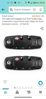

Mark, I had the same problem. I had to cut the shackles to free the zipper pulls. Once I got the pannier open, it was easy to unsip the liner, remove the two screws securing the lock and replacing it with an identical lock acquired from Amazon.com (2 locks for $18.99 plus tax)
