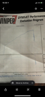

Well this will detail journey to 250hp. Ordered the 200hp kit and achieved 215hp 175tq. All Lush Racing bits for the heart. And now i will be adding a Lush Racing Cylinder Head strait from the master builder hands to the widowmaker. And with a little help from my buddies its to 250hp we go. 250hp was chosen for durability, 300n/a is no problem for Lush Racing it would be high maintenance and expensive and maybe not fun if racing and breaking stuff. So here we go. #LushRacing#LaidlawMS (current dyno attached)

Tell us more about the NLR head Kevin.
BigAir BigLift all masterfully matched up i can say for certain. Specs probally wont be devulged unless im given permission. But a Lush Racing cylinder head will talk for itself, once Conrad (my tuner) and i get it dialed in during tuning. With Nevilles adjustable cam gears its gonna be dialed in.
