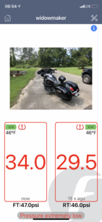

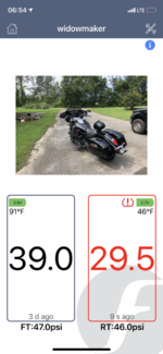

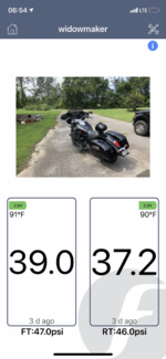

10 degress will change your psi from morning to morning, from 90 to 46 degrees f. Huge difference
