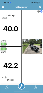

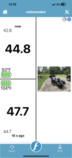

Not that it matters, just posting, getting ready for ride, 76deg. In garage, fubo confirms temp, and tires are set 42psi rear 40 psi front, outside its 10 degrees gonna be 20 degrees hotter. Psi in my tires goes up or down 1 psi for every 10degs change. So if bike had been sitting out side the pressures would be 43 44 rear and 41 42 front, just food for thought, today its 90 to start, if its 50 tomorrow to start im gonna be down 4 psi, i understand not the end of the world, just saying factors change tire pressure, weather, hooning, long distance, round town, its not exactly 42 42 for me, thats just me, easy. Drag strip, 26 rear 42 front. Hooning 38rear 36 front, interstate 42 42 or close it. Riding around house with this battlax that dont last long 42+ rear 40 fr. With an exdra max i run 40 rear most of the time in it, unless racing, then i drop it some. Its fun, i realize most aint doing this nonsense, but i do. Just sharing. 130/90 bias upfront Touring,
