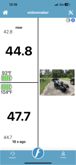

Effort matters, ride fast take chances alarm shut up im on my track 😎 rebound fast and slow set all in, fastest rebound, this thing is on rails gentleman, look at them seap groove edges, clean! No shaving inside or outside, tire not desentegrating, its a haus to ride with rebound set this fast, you got to get up in the seat. 👍
Without sounding condescending, but could someone please tell me what was just said! Preferably in the Queens English! 😂😂
Sorry mate I don’t understand Tennessee speak! 😳
I had to read it 3 times as well to get this out of it . . . The jist of it is he's pleased with his handling and tire wear. He also explains his suspension settings, compression set soft and rebound set hard. The wee pic shows tire temp (obviously been riding) and pressure.
