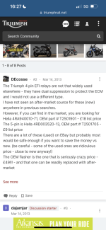

I have had a few relay issues lately, fuel pump went out, swapping relays did not fix, then rainman handed me a new relay to try and it fixed it, then starter button would nit start bike everytime so i changed relay and its fixed, the relays I’ve installed are not stock and according to decisse should be, the stock hella relays protect the ecu. Since the starting circut seems ok maybe install new stock relays to make sure there good. The ffuel pump relay welded the contacts together aand the starter relay has been working intermittently but a new relay fixed rhe starting issue.
