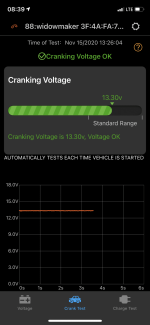

Dag gone skippy it’s important, heres my last crank test, fired right up
