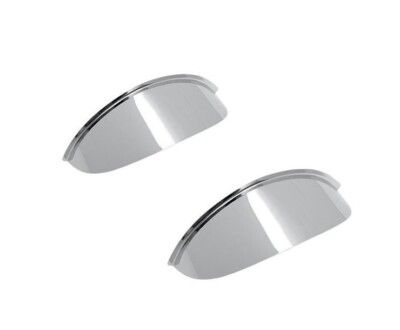

I laid my 2011 R3 Touring down last summer. All repairs complete except one upsetting detail! I can not find anywhere an auxiliary light visor. Any ideas, anyone?
I only have a stock Triumph 7" main headlight R3T one and a few Kuryakyn 5.25" inch ones that fit dual headlight Rockets.
LAMP VISORS - CHROME A9738068
Suitable for 4.5" Fog or Auxiliary Lamps A9938095 and A9938085
You will find Triumph America, Speedmaster and Thunderbird ones will fit fine too even same part number for the pair.
A9738068 - AUXILIARY LAMP VISOR​
I also found a part number for just the visor
Visor, 4.5” Lamp
A9730126
I just took a new switched Triumph Auxiliary lamp out of the box (Made in Taiwan;)) and the visible lens diameter is 4" with a .25" lip all around inside the lamp shell. So the actual visor should be about 4.5" wide (if a full 180 degree semi circle) so that an approx .25" or less lip all around fits under the lamp shell edge. 1/8 " should be fine and give clearance from shell but chrome lamp shell is actually 5" wide so plenty of space
They sell in pairs so easy to replace both of yours and still look fine.
Some visors will be less than an 180 degree arc and it depends how the seller measures and describes them.
4.5" generic Chinese ebay, Kuryakyn or Harley ones should work fine.

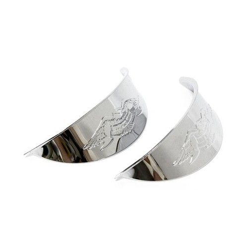

There are some aftermarket brows for Triumphs with the 'Triumph' text impressed. I think they come from India and and they do Triumph old style script versions too. I would need to track them down again but zillions of those types of things are available from India either directly or in your countrys retail and importers. They make them for stock old British bikes but brow visors are fairly identical except for lamp diameter and some may have slightly different lips that fit between lamp body and glass insert and held in place by the spring tensioners holding glass insert.
7", 5.25" and 4 inch are common also 3.5" and smaller are around but they are for round HD style indicator / blinkers. Best to buy from sellers with detailed measurements on screen as the reference is to the Lamp insert size not the actual brow/visors.
Eg. 4.5" CHROME SPOTLIGHT VISORS for Harley Davidson Softail Dyna Road King

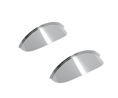

Pair Plain Chrome Visors Peak Motorcycle Spotlight 4.5" Spot
Great international postage too.
Pair (2) Live To Ride Eagle Spotlight Visors fit 4.5" (115mm) Motorcycle Lights
