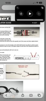

Good for a quick shifter settup 😎

Eh? Sorry, I've never used one, and I don't ride that fast these days anyway, but you still have to use your foot, unless there really is something new?
Err no mucker, you get an up and down button, you only use the clutch on pulling away and changing down. If you’ve got a fused ankle, that’ll be a brilliant set up for you!
When you push the electric shift button, the solenoid moves the shift lever...
Kind of like the pingel, but this has no button as that one does, the dynojet you just put pressure on shifter and its gonna send it like u say the solenoid moves shifter, fuel and timing cut as soon as you put pressure on shifter. Set rpm limits for shifting and shift times and it does the rest.
I did some reading, and the PCV quickshift can handle upshifts, but wrong throttle control for downshifts. Think I'll give it a miss. However.... I'm also looking at a stage 2 for my HD, when I can afford it, and stripping the PC5 to reuse there might be an option.
