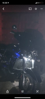

above it is said to be position bulb, and in my state( watch this thread) meets the law for a constant on in front white light, i put mine in a cut in half glass Churchill tube, my jw speaker, comes on with an array of cosmic get your attention, when i push the showtime, dimmer sword switch, 194 is a good bulb.
