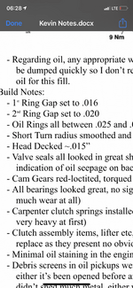

I hope its just a clogged filter that wont allow the fumes to exit. Ring seal is probably one of the most important pieces of making power, and loosing it, blow by can happen when rings arnt perfect, Rob built my motor and the static compression is quite high but i get no blowby and on tear down that chamber for crankcase exhaust is like a maze and its perfectly clean when i opened it up. Also not all rings are seated equally when seating rings, Hopefully you just have a clogged filter from those gasses w/oil residue in it. If a new filter , a new oil cap, does not fix it, a leakdown test will show problem with a ring or rings holding cylinder pressure. Hopefully a crankcase filter will do it and youre back to hooning it. 100 on a strait, hooligan😂😎
These are my ring gap notes. Im gonna go back and look at your thread for your numbers I remember you doing them. Hopefully though its not this, im just sharing info
