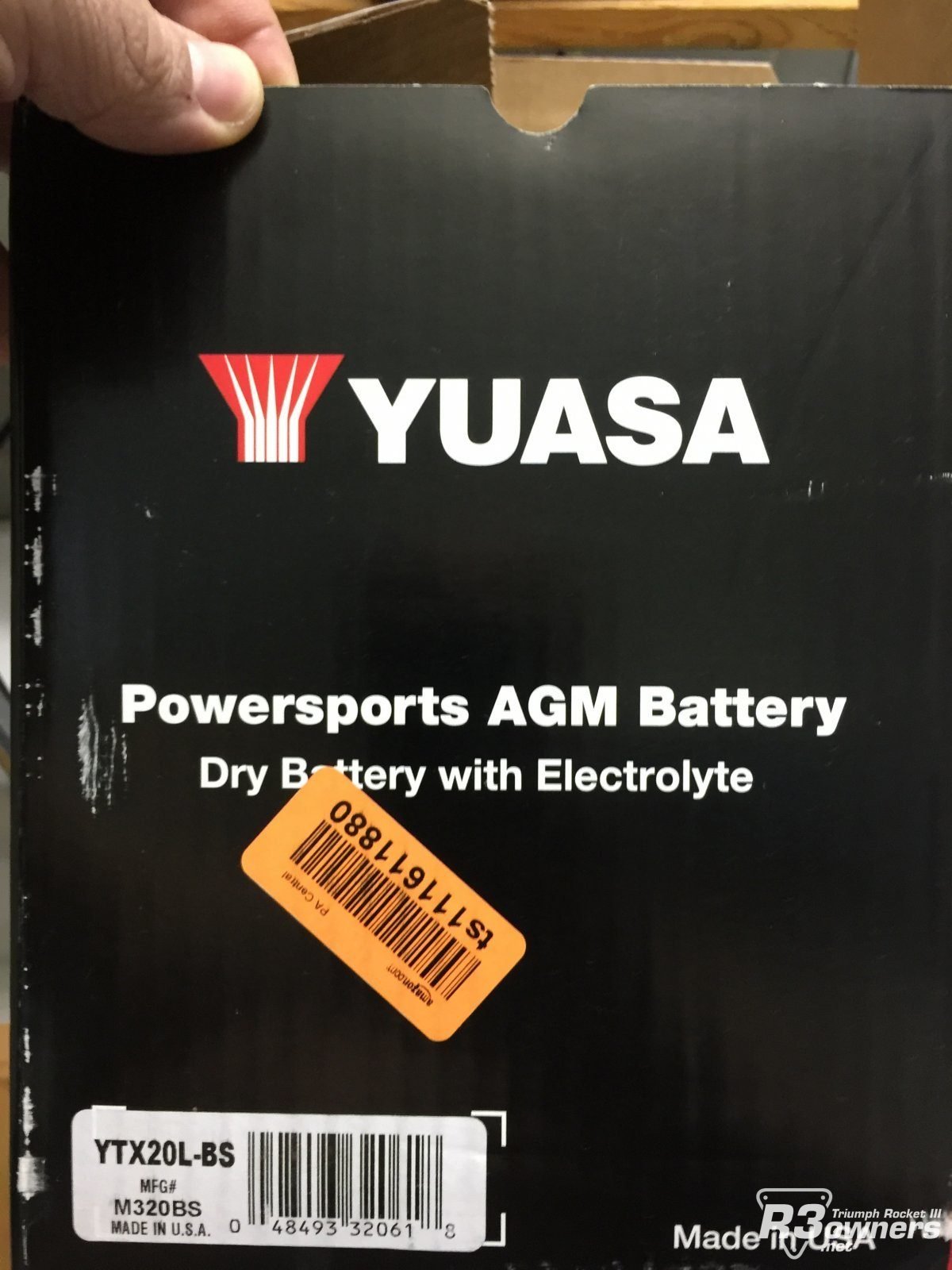

Is the OEM YUASA battery Lead acid or AGM? On the YUASA box is the first and only place I have read the RIII OEM battery is AGM. Is this correct?
AGM is like the Red Top batteries for cars, some say better than the older style. However, I just replaced my AGM Varta, 310 CCA battery with a 480 CCA lithium, I am tired of having to drive to work because the battery is a pansy.
Josh, IMO, you should have upgraded to the high performance model of that Yuasa battery, the YTX 20HL-BS, which costs about 35 bucks more and provides 40 additional CCA (310).

Josh, IMO, you should have upgraded to the high performance model of that Yuasa battery, the YTX 20HL-BS, which costs about 35 bucks more and provides 40 additional CCA (310)....
Woulda shoulda coulda...
Thanks for the battery code deciphering...
Simple question though...
Is the OEM BATTERY AGM?
Stock was a sealed battery according to - Service Manual page 18.14 and also states 12v 18 amp hour in spec sheets which is likely to be the lower CCA value one you have. The cheaper sealed batteries are still likely to be multi lead plates fixed in place with liquid (like water) acid. Not all sealed batteries are AGM but AGM are a sealed battery with thinner finer multiple lead sheets sandwiched between glass fibre mattes which makes them far more resistant to vibration and often using an acid electrolyte acid gel or thicker than water i.e. more viscous liquid acid. The service manual also provides details of how to fill and charge a new unsealed wet lead acid version in quite lengthy detail on page 18.14.
