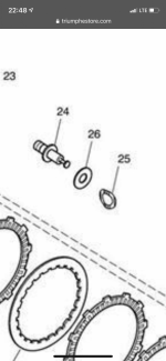

[/QUO you only need to use the wave washer with the new style lifter piece.
I too use the washer and the wave washer, maybe its like the detent springs some toss, dunno but i use like parts fiche says
I believe with new press. plt. you disregard the heavy washer, not required. Think I read that in parts drawing. Better double check that.
Im refering to #26
